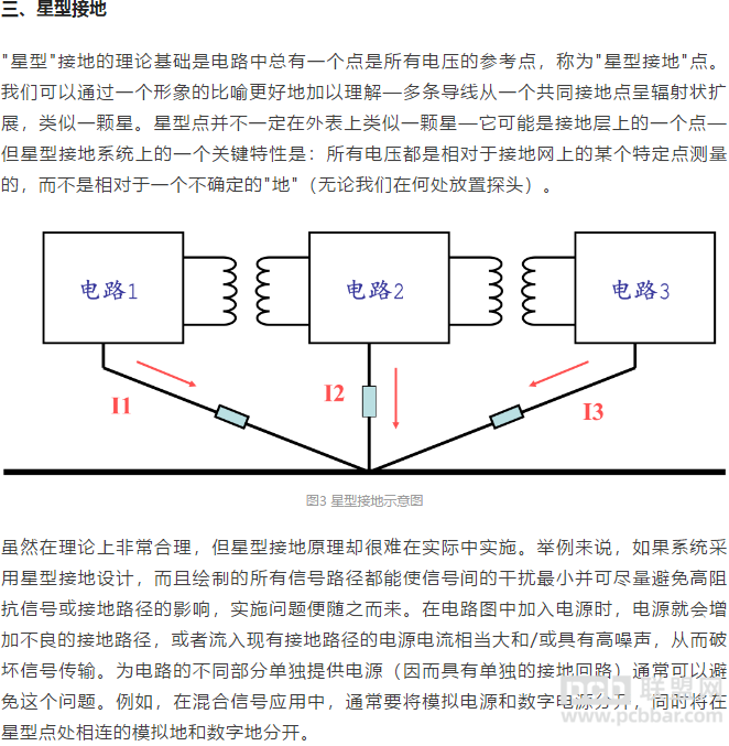

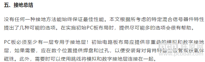

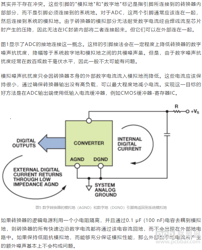

c86c844be4a09b5aedcd19358427e7ac.png ) A! Y( v& W* t( @- B! v+ M) Z
8 F  ~* |5 R. e- `% t fca17f7347682cb44c3df54cc8fabcfc.png 5 F# v# }" i* e" B( A' _" y  Y
6 s  A  S" S4 @6 o; R& ~( Z# N) S* t$ z0 S+ r% h+ V& n! X
) a6 i9 N1 K$ H( o; b
4 y" g4 U0 \- U( b9 ~- F2 i 59a04f3fde1dfe1150796c8c1d879c6c.png # G+ M+ Z6 X/ K' K+ N
