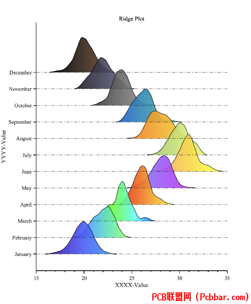

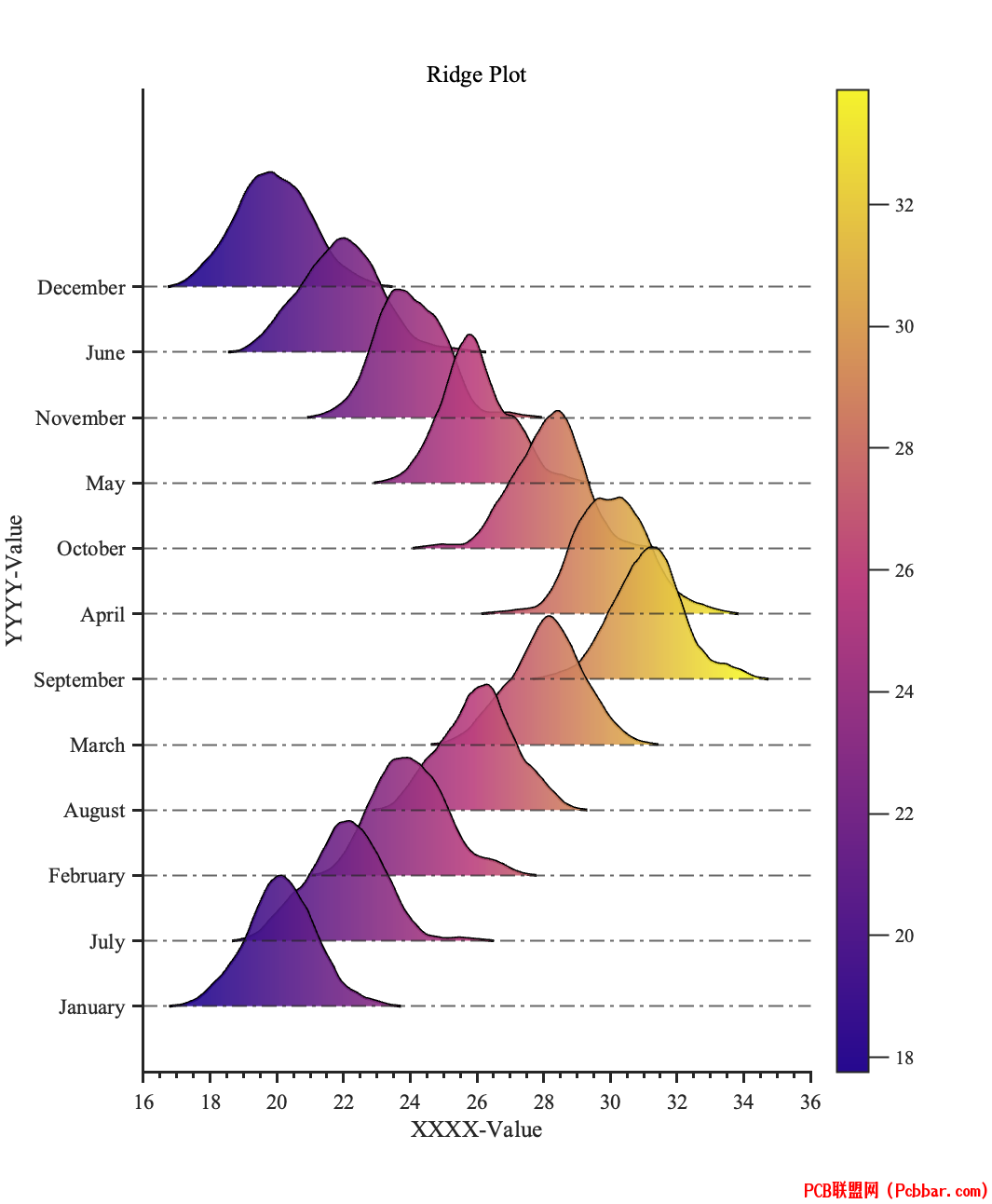

9 C7 B' M4 B. y; E4 s0 V( ~" N今天介绍一下山脊图,喜欢此推文的小伙伴们记得点赞+关注+分享!【尊重作者劳动成果,转载请注明推文链接和公众号名】上周去逛了一下商店看见一个笔架4 E$ n: R1 u* v. C% g0 {
5 M/ a8 Q3 Q- g. K这突然让我想起,这个不就像科研绘图的山脊图嘛,于是我打算用 MATLAB 复刻一个。
9 \* w4 e5 ?# I/ g! P  b
2 A' M1 U/ V6 b+ N& B  E$ J
4 Z- l3 b1 ~" v7 N8 ]. w效果图8 ^7 `/ V5 ^; [0 D% H" _) p+ V; W' v
& s- b; V* [7 q8 C+ G7 [- X, r
  J8 e5 ?; b0 E/ l
6 Q8 P2 R. s; a. G$ r山脊图介绍山脊图(Ridge Plot),也被称为Joy Plot,是一种用于可视化数据分布的图表,特别是用于显示多个组的分布情况。在这种图表中,每个组的数据分布都通过平滑的密度曲线来表示,这些曲线沿着垂直轴堆叠,形成类似山脊的视觉效果。山脊图是核密度估计(KDE)的一个应用,它提供了比传统的条形图或直方图更平滑的数据分布视图。

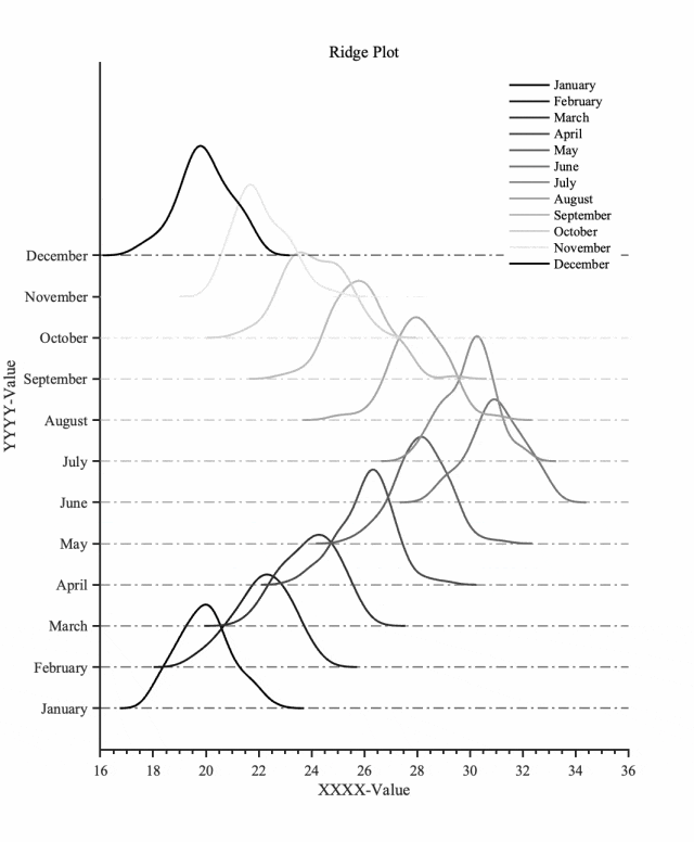

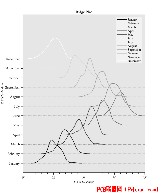

绘图教程线条山脊图
  • data = randn(100,12)+[ 20 22 24 26 28 31 30 28 26 24 22 20];lgLable= {'January', 'February', 'March', 'April', 'May', 'June','July', 'August', 'September', 'October', 'November', 'December'};colors=makeColorMap([0,0,0;1,1,1],12);figure('Position',[476 246 511 620])p=0.15;yTick=(1:size(data, 2))*p;for i = 1:size(data, 2)    [f, x] = ksdensity(data(:, i));    f=f+i*p;    pHandle=plot(x, f, 'LineWidth', 1.5,'color',colors(i,:));    hold on;    yline(yTick(i),'-.','LineWidth',1,'Color',pHandle.Color,'HandleVisibility','off')endgrid off;box off;legend(lgLable,'box','on','Color',[1,1,1]*0.95,'EdgeColor','none');set(gca, 'YTick',yTick , 'YTickLabel',lgLable,'LineWidth', 1.5, 'XMinorTick', 'on', 'TickDir', 'out', ...    'fontname','Times new Roman','color',[1,1,1]*0.9);xlabel('XXXX-Value');ylabel('YYYY-Value');title('Ridge Plot');hold off;0 Z8 N( F& {( H5 F" g/ ?8 f! q

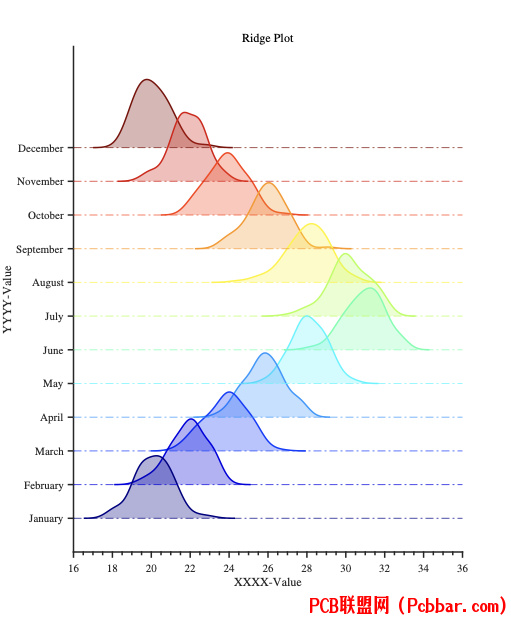

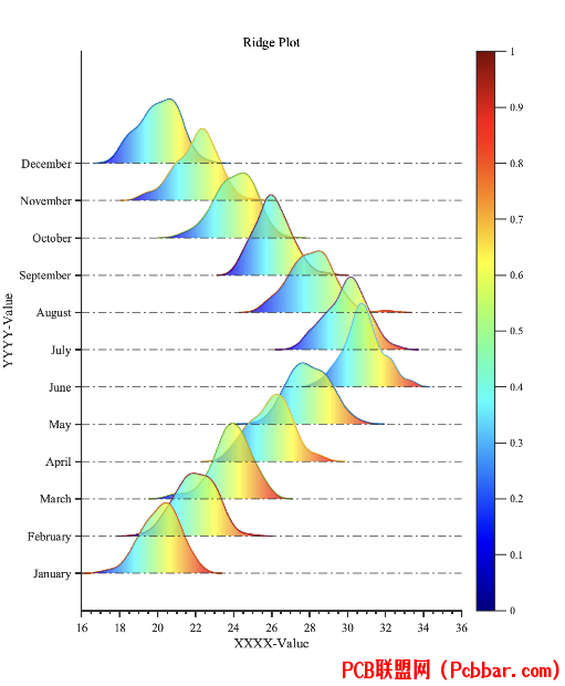

    1 ]' X! \/ d& ~5 U填充山脊图
  • data = randn(100,12)+[ 20 22 24 26 28 31 30 28 26 24 22 20];lgLable= {'January', 'February', 'March', 'April', 'May', 'June','July', 'August', 'September', 'October', 'November', 'December'};% colors=makeColorMap(winter,size(data, 2));colors=makeColorMap(jet,size(data, 2));figure('Position',[476 246 511 620])p =0.2;hold on;for i = size(data, 2):-1:1    [f, x] = ksdensity(data(:, i));    fShifted = f + i * p;    pHandle = plot(x, fShifted,'color',colors(i,:),'LineWidth', 1.5,'HandleVisibility', 'off');    yline(i * p, '-.', 'LineWidth', 1, 'Color', colors(i,:),'HandleVisibility', 'off')    Xfill = [x, fliplr(x)];    Yfill = [fShifted, ones(1, length(x)) * i * p];    fill(Xfill, Yfill, pHandle.Color, 'EdgeColor', 'none', 'FaceAlpha', 0.3);endyTick = (1:size(data, 2)) * p;set(gca, 'YTick', yTick, ...    'YTickLabel', lgLable, ...    'LineWidth', 1.5, 'XMinorTick', 'on', 'TickDir', 'out', ...    'fontname','Times new Roman');xlabel('XXXX-Value');ylabel('YYYY-Value');title('Ridge Plot');ax = gca;hold off;?

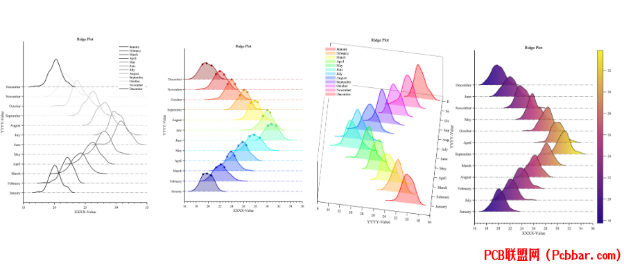

    & x, ~6 o( v! U  y) @3D填充山脊图
  • data = randn(100,12)+[ 20 22 24 26 28 31 30 28 26 24 22 20];lgLabel= {'January', 'February', 'March', 'April', 'May', 'June','July', 'August', 'September', 'October', 'November', 'December'};p = 0.2;xTick=(1:size(data, 2))*p;figure('Position',[476 246 511 620])hold on;colors=makeColorMap(hsv,size(data, 2));legendHandles = zeros(size(data, 2), 1);for i = 1:size(data, 2)    [f, y] = ksdensity(data(:, i));    xShifted = i * p;    plot3(xShifted * ones(size(f)), y, f, 'LineWidth', 1.5, 'Color', colors(i,:), 'HandleVisibility', 'off');    Yfill = [y, fliplr(y)];    Xfill = [xShifted * ones(1, length(y)), xShifted * ones(1, length(y))];    Zfill = [f, zeros(size(f))];    legendHandles(i)  = fill3(Xfill, Yfill, Zfill, colors(i,:), 'EdgeColor', 'none', 'FaceAlpha', 0.3); endgrid off;box on;legend(lgLabel,'box','on','Color',[1,1,1]*0.95,'EdgeColor','none','FontName','Times New Roman','location','best');set(gca, 'XTick',xTick, 'XTickLabel',lgLabel,'FontName','Times New Roman','linewidth',1)xlabel('XXXX-Value');ylabel('YYYY-Value');zlabel('ZZZ-Value');title('Ridge Plot');view([-83.4000   71.6830])hold off;8 T% g+ J# `8 z; }% F9 |
    % N3 H. l- z$ p$ [
    不同核山脊图、添加边际散点密度
  • data = randn(100,3)+[ 20  24 28];colors=makeColorMap(jet,size(data, 2));figure('Position',[476 246 511 620])p=0;hold on;yTick=(1:size(data, 2))*p;lineLength = 0.02; % 竖线的长度for i = size(data, 2):-1:1    [f, x] = ksdensity(data(:, i));    fShifted = f + i * p;    pHandle = plot(x, fShifted, 'color', colors(i,:), 'LineWidth', 1.5, 'HandleVisibility', 'off');    yline(i * p, '-.', 'LineWidth', 1, 'Color', colors(i,:), 'HandleVisibility', 'off');    Xfill = [x, fliplr(x)];    Yfill = [fShifted, ones(1, length(x)) * i * p];    fill(Xfill, Yfill, pHandle.Color, 'EdgeColor', 'none', 'FaceAlpha', 0.3);    for j = 1:length(data(:, i))        line([data(j, i), data(j, i)], [i * p, i * p + lineLength], 'Color', pHandle.Color, 'LineWidth', 1);    endendgrid off;box off;ax=gca;set(ax,'LineWidth', 1.5, 'XMinorTick', 'on', 'TickDir', 'out', ...    'fontname','Times new Roman','color',[1,1,1]*0.9);ax.YLim=[0,1];ax.XLim=[15,32];xlabel('XXXX-Value');ylabel('YYYY-Value');title('Ridge Plot');hold off;! \: \2 O- d' B6 y( w/ o# d8 C
    9 ~1 M' ^1 ]( A) A4 u0 t
    横坐标方向、全局渐变的散点图4 C% k" ^! ]! _- A( l/ V5 f
  • data = randn(100,12)+[ 20 22 24 26 28 31 30 28 26 24 22 20];lgLabel={'January', 'February', 'March', 'April', 'May', 'June',    'July', 'August', 'September', 'October', 'November', 'December'};p = 0.2;numColors = 256;% 创建一个从紫色到红色再到黄色的颜色映射colorMap =makeColorMap([0.1490    0.0353    0.5608;0.7305    0.2500    0.4922;0.9569    0.9490    0.1765],numColors);% 计算全局的x轴范围xMin = min(data, [], 'all');xMax = max(data, [], 'all');figure('Position',[476 246 511 620])hold on;for i = size(data, 2):-1:1    [f(i,:), x] = ksdensity(data(:, i), 'Kernel', 'triangle');    fShifted = f(i,:) + i * p; % 偏移每个分布    plot(x, fShifted, 'LineWidth', 1.5, 'color', 'k', 'HandleVisibility', 'off');    yline(i * p, '-.', 'LineWidth', 1, 'HandleVisibility', 'off');    for j = 1:length(x)-1        Xfill = [x(j), x(j+1), x(j+1), x(j)];        Yfill = [i * p, i * p, fShifted(j+1), fShifted(j)];        % 计算当前点的颜色比例        colorRatio = (x(j) - xMin) / (xMax - xMin);        colorIdx = min(numColors, max(1, round(colorRatio * (numColors - 1)) + 1));        fill(Xfill, Yfill, colorMap(colorIdx, :), 'EdgeColor', 'none', 'FaceAlpha', 0.9);    endend% 设置轴标签和标题yTick = (1:size(data, 2)) * p;set(gca, 'YTick', yTick, ...    'YTickLabel', lgLabel, ...    'LineWidth', 1.5, 'XMinorTick', 'on', 'TickDir', 'out', ...    'fontname','Times new Roman');xlabel('XXXX-Value');ylabel('YYYY-Value');title('Ridge Plot');% 设置颜色条colormap(colorMap);cBar = colorbar;cBar.TickDirection = 'out';cBar.LineWidth = 1;cBar.TickLength = 0.02;cBar.FontName = 'Times new Roman';caxis([xMin,xMax]);hold off;
    $ D7 o1 Y6 I8 k" G

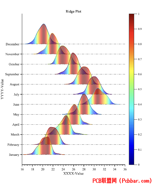

    5 ]& L2 G* H/ A7 M4 l! o; C横坐标方向、单核渐变图
  • data = randn(100,12) + [20 22 24 26 28 31 30 28 26 24 22 20];lgLabel = {'January', 'February', 'March', 'April', 'May', 'June', 'July', 'August', 'September', 'October', 'November', 'December'};numColors = 256; % 颜色数量colors = jet(numColors); % 使用jet颜色映射figure('Position',[476 246 511 620])p = 0.2;hold on;for i = size(data, 2):-1:1    [f, x] = ksdensity(data(:, i));    fShifted = f + i * p;    plot(x, fShifted, 'LineWidth', 1.5, 'HandleVisibility', 'off');    yline(i * p, '-.', 'LineWidth', 1, 'HandleVisibility', 'off');    colorGradient = linspace(1, numColors, length(x));    for j = 1:length(x)-1        Xfill = [x(j), x(j+1), x(j+1), x(j)];        Yfill = [i * p, i * p, fShifted(j+1), fShifted(j)];        fill(Xfill, Yfill, colors(round(colorGradient(j)), :), 'EdgeColor', 'none', 'FaceAlpha', 0.7);    endendyTick = (1:size(data, 2)) * p;set(gca, 'YTick', yTick, 'YTickLabel', lgLabel, ...    'LineWidth', 1.5, 'XMinorTick', 'on', 'TickDir', 'out', ...    'fontname', 'Times new Roman');xlabel('XXXX-Value');ylabel('YYYY-Value');title('Ridge Plot');colormap(colors);cBar = colorbar;cBar.TickDirection = 'out';cBar.LineWidth = 1;cBar.TickLength = 0.02;cBar.FontName = 'Times new Roman';hold off;/ K& G/ F8 H( I% N
    ; Z9 F0 I# K9 J8 L' V' o* W

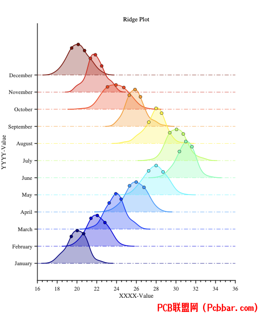

    每个山脊图设置不同颜色,且添加边际散点图
  • data = randn(100,12)+[ 20 22 24 26 28 31 30 28 26 24 22 20];lgLable = {'January', 'February', 'March', 'April', 'May', 'June', 'July', 'August', 'September', 'October', 'November', 'December'};figure('Position', [476 246 511 620])p = 0.3;lineLength = 0.04; % 竖线的长度colors=makeColorMap(hsv,size(data, 2));hold on;for i = size(data, 2):-1:1    [f, x] = ksdensity(data(:, i));    fShifted = f + i * p;    pHandle = plot(x, fShifted, 'color', colors(i,:), 'LineWidth', 1.5, 'HandleVisibility', 'off');    yline(i * p, '-.', 'LineWidth', 1, 'Color', colors(i,:), 'HandleVisibility', 'off');    Xfill = [x, fliplr(x)];    Yfill = [fShifted, ones(1, length(x)) * i * p];    fill(Xfill, Yfill, pHandle.Color, 'EdgeColor', 'none', 'FaceAlpha', 0.3);    for j = 1:length(data(:, i))        line([data(j, i), data(j, i)], [i * p, i * p + lineLength], 'Color', 'k', 'LineWidth', 1);    endendyTick = (1:size(data, 2)) * p;set(gca, 'YTick', yTick, ...    'YTickLabel', lgLable, ...    'LineWidth', 1.5, 'XMinorTick', 'on', 'TickDir', 'out', ...    'fontname', 'Times new Roman');xlabel('XXXX-Value');ylabel('YYYY-Value');title('Ridge Plot');# t% w2 A3 T: _! p, k/ E
    * S8 g/ @4 A8 p3 L& v+ T1 v每个山脊图设置不同颜色单核横向颜色渐变
  • data = randn(100,12)+[ 20 22 24 26 28 31 30 28 26 24 22 20];lgLabel = {'January', 'February', 'March', 'April', 'May', 'June', ...    'July', 'August', 'September', 'October', 'November', 'December'};p = 0.2;numColors = 256;% 创建12个不同的颜色映射,每个月一个colorMaps = cell(1, 12);colorList={parula,turbo,hsv,hot,cool,spring,summer,autumn,winter,gray,bone,copper,pink,jet,lines,colorcube,prism,flag};for i = 1:12    colorMaps{i} = makeColorMap(colorList{i}, numColors);end% 计算全局的x轴范围xMin = min(data, [], 'all');xMax = max(data, [], 'all');figure('Position', [476 246 511 620])hold on;for i = size(data, 2):-1:1    [f(i,:), x] = ksdensity(data(:, i), 'Kernel', 'triangle');    fShifted = f(i,:) + i * p; % 偏移每个分布    plot(x, fShifted, 'LineWidth', 1.5, 'color', 'k', 'HandleVisibility', 'off');    yline(i * p, '-.', 'LineWidth', 1, 'HandleVisibility', 'off');    currentColorMap = colorMaps{i};    for j = 1:length(x)-1        Xfill = [x(j), x(j+1), x(j+1), x(j)];        Yfill = [i * p, i * p, fShifted(j+1), fShifted(j)];        colorRatio = (x(j) - xMin) / (xMax - xMin);        colorIdx = min(numColors, max(1, round(colorRatio * (numColors - 1)) + 1));        fill(Xfill, Yfill, currentColorMap(colorIdx, :), 'EdgeColor', 'none', 'FaceAlpha', 0.9);    endendyTick = (1:size(data, 2)) * p;set(gca, 'YTick', yTick, ...    'YTickLabel', lgLabel, ...    'LineWidth', 1.5, 'XMinorTick', 'on', 'TickDir', 'out', ...    'fontname', 'Times new Roman');xlabel('XXXX-Value');ylabel('YYYY-Value');title('Ridge Plot');hold off;0 J3 N7 X7 e! K% W8 {: d2 B
    6 K$ I. P# u1 ~; @" S$ L
    山脊图的 Y值映射颜色变化
    ' \. l( P1 [# O
  • data = randn(100,12) + [20 22 24 26 28 31 30 28 26 24 22 20];lgLabel = {'January', 'February', 'March', 'April', 'May', 'June', 'July', 'August', 'September', 'October', 'November', 'December'};numColors = 100; % 颜色数量colors =makeColorMap(jet, numColors);figure('Position',[476 246 511 620])p = 0.2;hold on;for i = size(data, 2):-1:1    [f, x] = ksdensity(data(:, i));    fShifted = f + i * p;    plot(x, fShifted, 'LineWidth', 1.5, 'HandleVisibility', 'off');    yline(i * p, '-.', 'LineWidth', 1, 'HandleVisibility', 'off');    % 计算整个分布的最小和最大纵坐标    minY = min(fShifted);    maxY = max(fShifted);    for j = 1:length(x)-1        Xfill = [x(j), x(j+1), x(j+1), x(j)];        Yfill = [i * p, i * p, fShifted(j+1), fShifted(j)];        avgY = mean(Yfill(3:4));         colorIdx = round(((avgY - minY) / (maxY - minY)) * (numColors - 1)) + 1;        fill(Xfill, Yfill, colors(colorIdx, :), 'EdgeColor', 'none', 'FaceAlpha', 0.6);    endendyTick = (1:size(data, 2)) * p;set(gca, 'YTick', yTick, 'YTickLabel', lgLabel, ...    'LineWidth', 1.5, 'XMinorTick', 'on', 'TickDir', 'out', ...    'fontname', 'Times new Roman');xlabel('XXXX-Value');ylabel('YYYY-Value');title('Ridge Plot');colormap(colors);cBar = colorbar;cBar.TickDirection = 'out';cBar.LineWidth = 1;cBar.TickLength = 0.02;cBar.FontName = 'Times new Roman';hold off;
    8 A2 A  o$ f3 c& B  b; ]5 S7 y
    & }! ^5 Z! |# g, |
    ( A+ D# Y4 Z4 L0 H( i# J, e7 y  N四分位点9 n; f: j/ _) ^" ~& ]
  • data = randn(100,12) + [20 22 24 26 28 31 30 28 26 24 22 20];lgLabel = {'January', 'February', 'March', 'April', 'May', 'June', 'July', 'August', 'September', 'October', 'November', 'December'};colors = makeColorMap(jet, size(data, 2));figure('Position', [476 246 511 620])p = 0.2;hold on;for i = size(data, 2):-1:1    [f, x] = ksdensity(data(:, i));    fShifted = f + i * p;    pHandle = plot(x, fShifted, 'color', colors(i,:), 'LineWidth', 1.5, 'HandleVisibility', 'off');    yline(i * p, '-.', 'LineWidth', 1, 'Color', colors(i,:), 'HandleVisibility', 'off')    Xfill = [x, fliplr(x)];    Yfill = [fShifted, ones(1, length(x)) * i * p];    fill(Xfill, Yfill, pHandle.Color, 'EdgeColor', 'none', 'FaceAlpha', 0.3);    % 计算并标记四分位点    quartiles = quantile(data(:, i), [0.25 0.50 0.75]);    for q = quartiles        [~, idx] = min(abs(x-q));        plot(q, fShifted(idx), 'o', 'MarkerFaceColor', pHandle.Color, 'MarkerEdgeColor', 'k');    endendyTick = (1:size(data, 2)) * p;set(gca, 'YTick', yTick, ...    'YTickLabel', lgLabel, ...    'LineWidth', 1.5, 'XMinorTick', 'on', 'TickDir', 'out', ...    'fontname', 'Times new Roman');xlabel('XXXX-Value');ylabel('YYYY-Value');title('Ridge Plot');hold off;
    + ~' {* B: `+ F6 x1 o% X
    7 Z8 I# L/ \: x: ~7 r5 O$ o
  • data = randn(100,12) + [20 22 24 26 28 31 30 28 26 24 22 20];lgLabel = {'January', 'February', 'March', 'April', 'May', 'June', 'July', 'August', 'September', 'October', 'November', 'December'};colors = makeColorMap(jet, size(data, 2));figure('Position', [476 246 511 620])p = 0.2;hold on;for i = size(data, 2):-1:1    [f, x] = ksdensity(data(:, i));    fShifted = f + i * p;    pHandle = plot(x, fShifted, 'color', colors(i,:), 'LineWidth', 1.5, 'HandleVisibility', 'off');    yline(i * p, '-.', 'LineWidth', 1, 'Color', colors(i,:), 'HandleVisibility', 'off');    Xfill = [x, fliplr(x)];    Yfill = [fShifted, ones(1, length(x)) * i * p];    fill(Xfill, Yfill, pHandle.Color, 'EdgeColor', 'none', 'FaceAlpha', 0.3);    % 计算并标记四分位点,并绘制竖线    quartiles = quantile(data(:, i), [0.25 0.50 0.75]);    for q = quartiles        [~, idx] = min(abs(x-q));        plot(q, fShifted(idx), 'o', 'MarkerFaceColor', pHandle.Color, 'MarkerEdgeColor', 'k');        line([q q], [fShifted(idx) i * p], 'Color', pHandle.Color, 'LineStyle', '-.','LineWidth', 1);    endendyTick = (1:size(data, 2)) * p;set(gca, 'YTick', yTick, ...    'YTickLabel', lgLabel, ...    'LineWidth', 1.5, 'XMinorTick', 'on', 'TickDir', 'out', ...    'fontname', 'Times new Roman');xlabel('XXXX-Value');ylabel('YYYY-Value');title('Ridge Plot');hold off;
    - |. |! S' t  t$ W: r7 p
