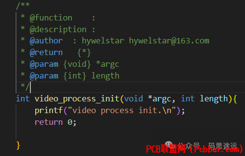

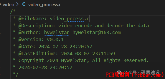

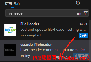

前言在写代码过程中,是否看到那些大厂的代码写的注释都比较规范和漂亮,曾经的自己还在那里CV。修改代码都会涉及创建文件创建新的函数,但在这过程中,如何去规范或者丝滑去写好这部分,其实在代码的世界里面只要你好好应用好工具,一切都变得简单,因为工具会Auto,在这个过程中,你只需要去修改一点点东西既可。插件1:koroFileHeader采用插件1的效果:
文件注释效果:
函数注释效果:
出现快捷键不能用的问题:
按下ctrl+shift+p,
1.修改文件头快捷键:搜索fileheader,选择右侧设置图标,就进入按键绑定页面。2.修改函数注释快捷键:搜索cursorTip,选择右侧设置图标,就进入按键绑定页面。
CommandKeybindingWhenSourcefileheaderCtrl+Alt+IeditorTextFocusUsercursorTipCtrl+Alt+TeditorTextFocusUser使用方法:Ctrl+Alt+I将会插入文件头部注释;Ctrl+Alt+T将会对当前鼠标函数位置所在函数进行函数注释;在文件头部"fileheader.configObj"到"files.exclude"settings 文件配置【配置还包含其他插件配置】:该配置文件路径:C:\Users\你的用户名\AppData\Roaming\Code\User\settings.json

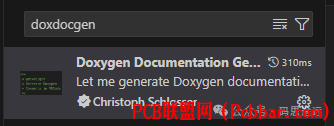

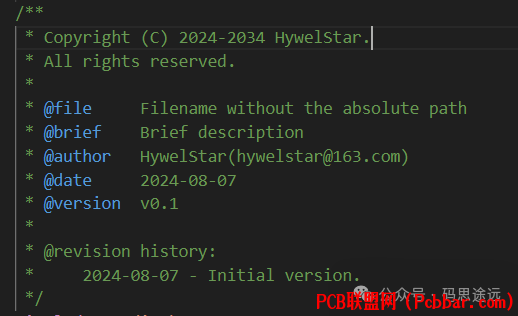

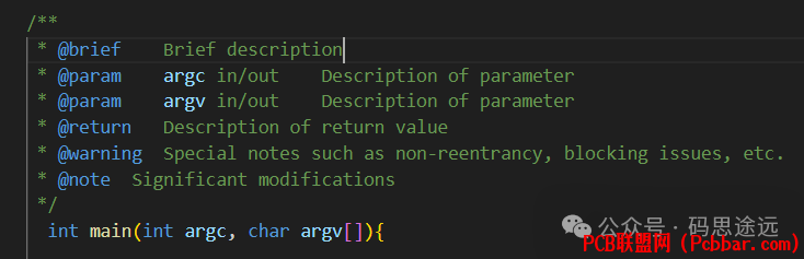

  • {    "doxdocgen.file.copyrightTag": [        "Copyright (C) 2024-2034 HywelStar.",        "All rights reserved.",        "",            ],
        "doxdocgen.file.customTag": [        "@version         v0.1",        "",        "@revision history:",        "         {date} - Initial version."    ],
        "doxdocgen.file.fileTemplate": "@file          Filename without the absolute path",    "doxdocgen.generic.authorTag": "@author          HywelStar(hywelstar@163.com)",    "doxdocgen.generic.dateTemplate": "@date          {date}",    "doxdocgen.generic.briefTemplate": "@brief          Brief description",    "doxdocgen.generic.returnTemplate": "@return          Description of return value",    "doxdocgen.generic.paramTemplate": "@param          {param} in/out          Description of parameter",    "doxdocgen.generic.customTags": [        "@warning         Special notes such as non-reentrancy, blocking issues, etc.",        "@note         Significant modifications"    ],
        "doxdocgen.file.fileOrder": [        "copyright",        "", // New line        "file",        "brief",        "author",        "date",        "custom"    ],
        "doxdocgen.generic.order": [        "brief",        "param",        "return",        "custom"    ],    "C_Cpp.errorSquiggles": "enabled",    "files.associations": {        "*.def": "c"    }}
