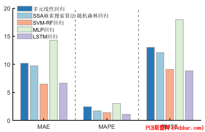

    4 ~" Z% L2 I" V: T( X2.误差柱状对比图
    , {6 O0 W# I5 Y. j# T
      D$ H. D0 x. {) X6 a  z
    Tips:建议选取量纲差别不大的误差衡量指标,不然可能会有点丑
    8 o1 c' C  u1 e# x; c
  • Test_all=[];for j=1:size(data_pre_all,2)    y_test_predict=data_pre_all(:,j);    test_y=data_true;    test_MAE=sum(abs(y_test_predict-test_y))/length(test_y) ;           test_MAPE=sum(abs((y_test_predict-test_y)./test_y))/length(test_y);      test_MSE=(sum(((y_test_predict-test_y)).^2)/length(test_y));     test_RMSE=sqrt(sum(((y_test_predict-test_y)).^2)/length(test_y));      test_R2= 1 - (norm(test_y - y_test_predict)^2 / norm(test_y - mean(test_y))^2);       Test_all=[Test_all;test_MAE test_MAPE test_MSE test_RMSE test_R2];end%%str={'真实值','多元线性回归','SSA麻雀搜索算法 随机森林回归','SVM-RF回归' ,'MLP回归','LSTM回归'};str1=str(2:end);str2={'MAE','MAPE','MSE','RMSE','R2'};data_out=array2table(Test_all);data_out.Properties.VariableNames=str2;data_out.Properties.RowNames=str1;disp(data_out)%% 柱状图 MAE MAPE RMSE 柱状图适合量纲差别不大的color=    [0.1569    0.4706    0.7098    0.6039    0.7882    0.8588    0.9725    0.6745    0.5490    0.8549    0.9373    0.8275       0.7451    0.7216    0.8627    0.7843    0.1412    0.1373    1.0000    0.5333    0.5176      0.5569    0.8118    0.7882       1.0000    0.5333    0.5176];figure('Units', 'pixels', ...    'Position', [300 300 660 375]);plot_data_t=Test_all(:,[1,2,4])';b=bar(plot_data_t,0.8);hold on* t* g8 F* g* s4 ^) g1 `5 D! s4 S, [
    for i = 1 : size(plot_data_t,2)    x_data(:, i) = b(i).XEndPoints'; end6 d- S6 R6 Y6 N3 A% \
    for i =1:size(plot_data_t,2)b(i).FaceColor = color(i,:);b(i).EdgeColor=[0.6353    0.6314    0.6431];b(i).LineWidth=1.2;end
    ' O8 e; S- Y  v5 @; ofor i = 1 : size(plot_data_t,1)-1    xilnk=(x_data(i, end)+ x_data(i+1, 1))/2;    b1=xline(xilnk,'--','LineWidth',1.2);    hold onend ! |' b2 n* N9 e. `6 s
    ax=gca;legend(b,str1,'Location','best')ax.XTickLabels ={'MAE', 'MAPE', 'RMSE'};set(gca,"FontSize",12,"LineWidth",2)box offlegend box off: ]) A5 L5 B% f

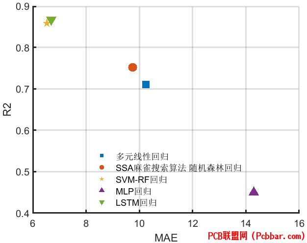

    3.误差散点对比图
    : V: X. F, Y( i$ l
    7 Q# W0 k# P2 d9 U; o
    Tips:可以任意选择两个误差衡量维度
    4 v* B0 r5 C1 }
  • figureplot_data_t1=Test_all(:,[1,5])';MarkerType={'s','o','pentagram','^','v'};for i = 1 : size(plot_data_t1,2)   scatter(plot_data_t1(1,i),plot_data_t1(2,i),120,MarkerType{i},"filled")   hold onendset(gca,"FontSize",12,"LineWidth",2)box offlegend box offlegend(str1,'Location','best')xlabel('MAE')ylabel('R2')grid on. Q4 [% q1 a- ^, ], j& }, C9 }; L

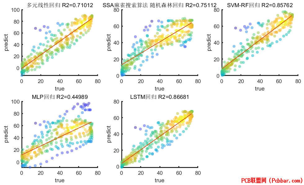

    + U# W) U- G) y0 u" Y2 H2 h* Z4.误差密度散点图) X6 ?0 g0 p* L2 k, v+ v% P
    ; `. r5 b) [) t% x. U0 |
    - b. v, a! P2 p8 X) P% G) J
  • figure('Units', 'pixels', ...    'Position', [150 150 920 500]);for i=1:5    subplot(2,3,i)     n=50;     X=double(data_true);     Y=double(data_pre_all(:,i));     M=polyfit(X,Y,1);     Y1=polyval(M,X);    XList=linspace(min(X),max(X),n);    YList=linspace(min(Y),max(Y),n);    [XMesh,YMesh]=meshgrid(XList,YList);    F=ksdensity([X,Y],[XMesh(:),YMesh(:)]);    ZMesh=reshape(F,size(XMesh));    H=interp2(double(XMesh),double(YMesh),double(ZMesh),X,Y);    scatter(data_true,data_pre_all(:,i),35,'filled','CData',H,'MarkerFaceAlpha',.5);    hold on    plot(X(1:10:end),Y1(1:10:end),'--','LineWidth',1.2)    hold on    str_label=[str1{1,i},' ','R2=',num2str(Test_all(i,end))];    title(str_label)    set(gca,"FontSize",10,"LineWidth",1.5)    xlabel('true')    ylabel('predict')end& ]: r( L! k7 ?1 \) u  a

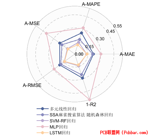

    9 t- |/ J' q) v) _0 D1 u5.误差雷达图
    6 r' d/ w9 W$ N# _5 m8 G
    7 E) I2 g  B. s, X- \8 [
    Tips:为了让图片更美观将多个维度评价指标进行归一化处理了
    ( k0 ?( _; O# e3 q+ x: o
  • figure('Units', 'pixels', ...    'Position', [150 150 520 500]);Test_all1=Test_all./sum(Test_all);  %把各个指标归一化到一个量纲Test_all1(:,end)=1-Test_all(:,end);RC=radarChart(Test_all1);str3={'A-MAE','A-MAPE','A-MSE','A-RMSE','1-R2'};RC.PropName=str3;RC.ClassName=str1;RC=RC.draw(); RC.legend();colorList=[78 101 155;          138 140 191;          184 168 207;          231 188 198;          253 207 158;          239 164 132;          182 118 108]./255;for n=1:RC.ClassNum    RC.setPatchN(n,'Color',colorList(n,:),'MarkerFaceColor',colorList(n,:))end
    ! @+ A! z! b4 y8 D1 _6 X本图参考了公众号:slandarer随笔1 r8 M- Y% k) X$ G
    https://mp.weixin.qq.com/s/8Lu7yBs3cLlZk9bPStdgUA
    : O2 a3 u$ d5 Y: o) k6 M+ D+ V

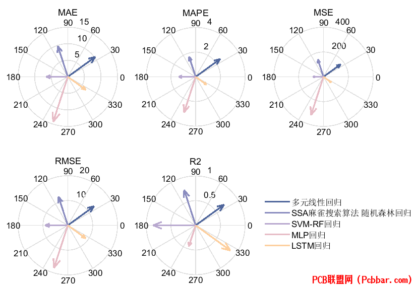

    6.误差罗盘图
    - x5 c+ D3 g* k/ W9 `/ ]( t4 y
    ' G" j" {0 e7 o9 J) ?% o! ^- M
  • figure('Units', 'pixels', ...    'Position', [150 150 920 600]);t = tiledlayout('flow','TileSpacing','compact');for i=1:length(Test_all(:,1))nexttileth1 = linspace(2*pi/length(Test_all(:,1))/2,2*pi-2*pi/length(Test_all(:,1))/2,length(Test_all(:,1)));r1 = Test_all(:,i)';[u1,v1] = pol2cart(th1,r1);M=compass(u1,v1);for j=1:length(Test_all(:,1))    M(j).LineWidth = 2;    M(j).Color = colorList(j,:);
    8 t' u) W! V, @) jend   title(str2{i})set(gca,"FontSize",10,"LineWidth",1)end legend(M,str1,"FontSize",10,"LineWidth",1,'Box','off','Location','southoutside')" N7 q# A) v* e
