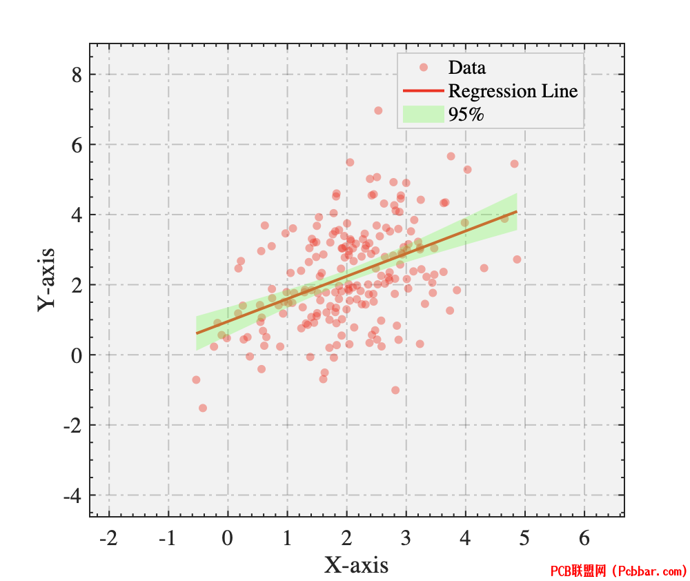

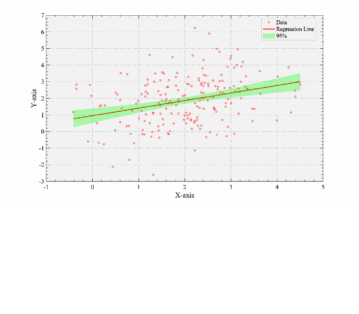

! U' U0 B* V( D$ g& }回归线置信区间画法
6 s3 D4 r! _; y" s, q
7 {  \0 P3 b' Z& o" a介绍一下绘制回归线置信区间的两种方式  p3 k/ R, n2 i1 O& s; C3 |$ L
一种方法是:
, ^1 T. i  P- R
  • clc;clear;close all;%--------------------------------------------------------------------------% @Author: 好玩的Matlab% @公众号:好玩的Matlab% @Created: 09,06,2023% @Email:2377389590@qq.com% 尊重劳动成果,转载请备注推文链接和公众号名。% @Disclaimer: This code is provided as-is without any warranty.%--------------------------------------------------------------------------% 使用提供的数据data = repmat([2 2], 200, 1) + randn(200, 2) * [1 .5; 0 1.32];xData = data(:, 1);yData = data(:, 2);% 绘制散点图figure('Position',[383 355 886 507]);scatter(xData, yData, 'r', 'filled', 'MarkerEdgeColor', 'none', 'MarkerFaceAlpha', 0.4);hold on;% 进行线性回归linearModel = fitlm(xData, yData);% 计算回归曲线和置信区间xFit = linspace(min(xData), max(xData), 200)';[yPred, yConfInterval] = predict(linearModel, xFit, 'Alpha', 0.05); % 95%置信区间% 绘制回归曲线plot(xFit, yPred, 'r', 'LineWidth', 2);% 使用fill函数绘制置信区间fill([xFit; flipud(xFit)], [yConfInterval(:, 1); flipud(yConfInterval(:, 2))], 'g', 'FaceAlpha', 0.3, 'EdgeColor', 'none');defaultAxeslegend(gca, 'Data', 'Regression Line','95%','Confidence Interval','box','on','Location','best','EdgeColor', [1 1 1]*0.8);?2 r4 k" U+ P" Z5 Y) @. v, b# k
    6 z5 `& y# q2 b% c8 M另一种方法是:
    7 {5 M2 B( q1 V
  • clc;clear;close all;%--------------------------------------------------------------------------% @Author: 好玩的Matlab% @公众号:好玩的Matlab% @Created: 09,06,2023% @Email:2377389590@qq.com% 尊重劳动成果,转载请备注推文链接和公众号名。% @Disclaimer: This code is provided as-is without any warranty.%--------------------------------------------------------------------------% 使用提供的数据data = repmat([2 2], 200, 1) + randn(200, 2) * [1 .5; 0 1.32];xData = data(:, 1);yData = data(:, 2);% 创建图形窗口并持有当前图figure('Position',[383 355 886 507]);hold on;% 使用polyfit进行线性拟合[polyCoeff, polyStruct] = polyfit(xData, yData, 1);xFit = linspace(min(xData), max(xData), 200);[yFit, fitDelta] = polyval(polyCoeff, xFit, polyStruct);alpha = 0.05;  % 对于95%置信区间zValue = norminv(1 - alpha/2, 0, 1);  % 这将返回1.960% 计算置信区间upperConfInt = yFit + zValue .* fitDelta;lowerConfInt = yFit - zValue .* fitDelta;% 绘制原始数据scatter(xData, yData, 'r', 'filled', 'MarkerEdgeColor', 'none', 'MarkerFaceAlpha', 0.4);% 绘制拟合曲线plot(xFit, yFit, 'r', 'LineWidth', 2.5);% 使用fill函数绘制置信区间fill([xFit, fliplr(xFit)], [upperConfInt, fliplr(lowerConfInt)], 'g', 'EdgeColor', 'none', 'FaceAlpha', 0.15);defaultAxeslegend(gca, 'Data', 'Regression Line','95%','Confidence Interval','box','on','Location','best','EdgeColor', [1 1 1]*0.8);5 V. G, o+ ?6 e! o7 A5 t# g

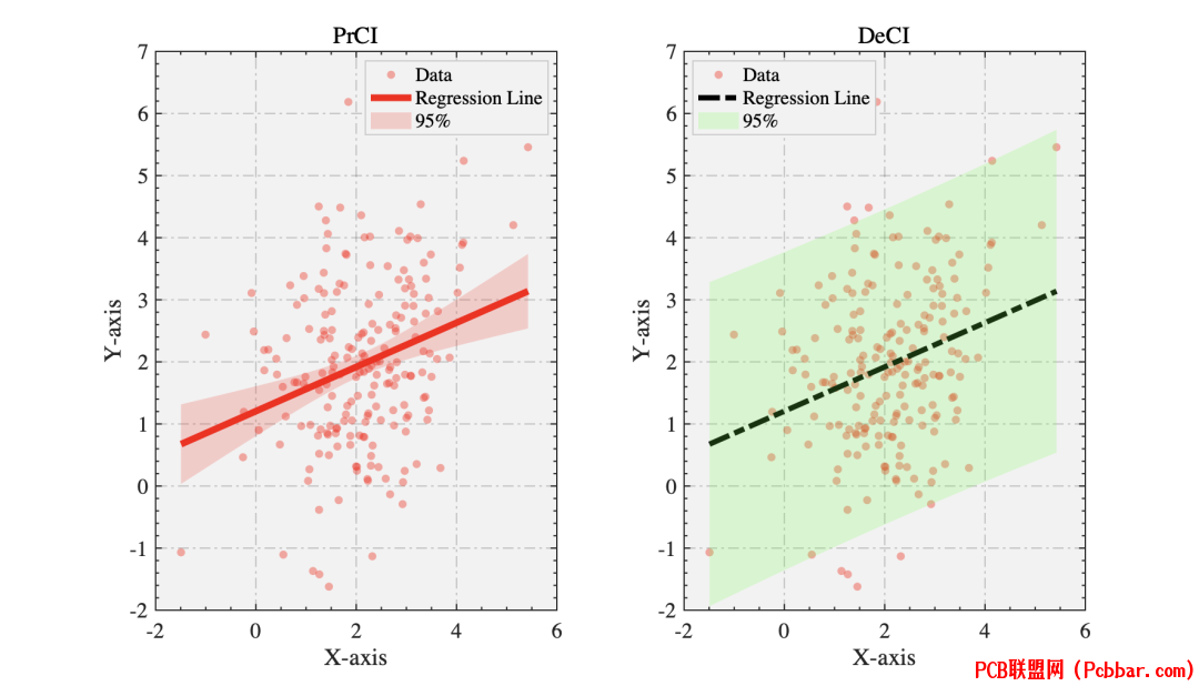

    原理介绍
    & K$ k7 P) d) z简单介绍一下这两种方式的不同:
    $ U7 ~. `7 @. M- c: T) Z1 h) c第一组代码使用了 fitlm 和 predict 函数,这是基于更复杂的线性模型拟合。这种方法计算了95%的置信区间,这个区间给出了模型预测响应值的不确定性。第二组代码使用了polyfit和 polyval 函数,用于多项式拟合。这里用的是多项式的一阶(线性)拟合。polyval 返回了拟合值和预测的标准误差,并假设这个标准误差是正态分布的。然后,它使用这个标准误差来计算了一个简化的95%置信区间(yFit + zValue* fitDelta)。其中:在正态分布中,以下是关于置信区间和标准偏差距离均值的规律:
  • 大约 68% 的数据点位于距离均值 1 个标准偏差以内的区间。
  • 大约 95% 的数据点位于距离均值 2 个标准偏差以内的区间。
  • 大约 99.7% 的数据点位于距离均值 3 个标准偏差以内的区间。这些规则是基于正态分布的数学属性,特别是在描述数据集分布的集中趋势和离散程度方面。这些比例也常被称为 "68-95-99.7" 规则或者 "三西格玛(Three-Sigma Rule)"或者“拉依达(Laplace)” 规则。很容易得出要想得到95%的置信区间,则:  ;
    / Q* C9 {( a4 I# q要得到任意的置信区间则用以下代码计算:9 y0 ?( D  {5 u" G2 R- T5 P$ y
  • alpha = 0.05;  % 对于95%置信区间zValue = norminv(1 - alpha/2, 0, 1);  % 这将返回1.960% 计算置信区间upperConfInt = yFit + zValue .* fitDelta;lowerConfInt = yFit - zValue .* fitDelta;由于这两种方法背后的统计模型和假设不同,所以得到的置信区间也可能会不同。具体使用哪一种方法取决于你的数据特性和需求。如果你的数据更适合一个复杂的线性模型,并且你希望考虑更多的变量和相互作用,fitlm 可能会更适合。如果你的数据是简单的并且你只是需要一个快速和简单的拟合,polyfit 和 polyval 可能就足够了。fitlm 方法更全面,计算的置信区间通常更为准确,特别是当数据复杂或存在不确定性时。
    - s% g8 l& }) w, t+ B. }& xpolyfit 方法则更简单和快速,但可能不如 fitlm 那样准确。
    + p$ p/ ~3 o/ F$ C& F& j6 a9 f总结:两个不同的置信区间,是因为这两种方法用不同的方式来估计这个区间。根据你的具体需求和数据的性质,选择其中一种方法。" P5 K2 R' u/ ~) c0 I2 C/ C( |3 H

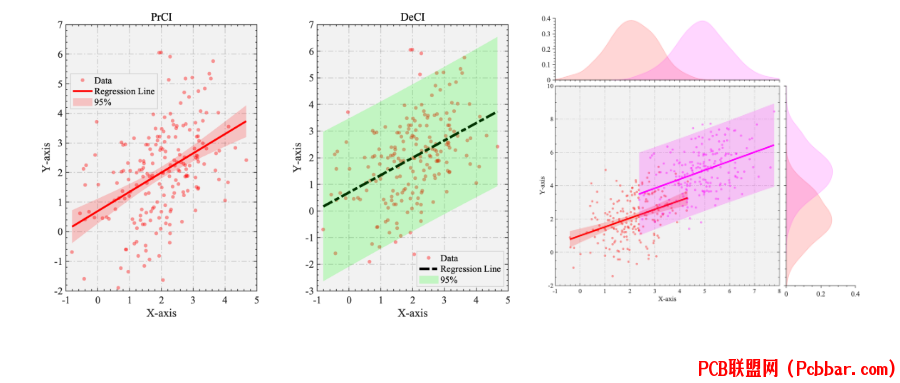

    % O4 P$ d% b! M0 R  T% A调用方式如下# R' W+ g$ [) _! w1 m! t
    我写了个PlotRegConfInt类函数,方便直接调用绘制两种置信区间图。
    6 r- D( R9 H/ i9 f
  • classdef PlotRegConfInt    %--------------------------------------------------------------------------    % @Author: 好玩的Matlab    % @公众号:好玩的Matlab    % @Created: 09,06,2023    % @Email:2377389590@qq.com    % 尊重劳动成果,转载请备注推文链接和公众号名。    % @Disclaimer: This code is provided as-is without any warranty.    %--------------------------------------------------------------------------    properties        XData;  % x数据        YData;      % y数据        Type ='prCI'   % 绘制方法        % =============【PrCI】=====================        % 使用 predict 函数计算置信区间        % 在你给出的 MATLAB 代码中,predict 函数用于计算置信区间,这一计算是基于特定的统计模型(在这里是线性模型)        % 和数据。这个方法考虑了数据的整体分布和模型参数的不确定性,并给出了一个关于预测值可能范围的精确估计。        % 1、全面性:它考虑了模型参数的不确定性和数据的内在变异性。        % 2、准确性:使用模型参数的标准误差和协方差矩阵,它可以非常精确地估计预测值的不确定性。        % 3、灵活性:你可以选择不同的置信级别(例如 95%、99% 等)        %==============【DeCI】==============================        % 使用 yfit +-  zValue x sigma 计算置信区间        % 这种方法更为简单和直观,通常用于快速估计预测值的不确定性。它通常假设误差是正态分布的,        % 并用标准偏差(δ)来量化这种不确定性。        % 1、简单性:不需要复杂的模型或计算。        % 2、快速性:很容易计算。        % 3、局限性:这种方法通常假定误差是正态分布的,并且不考虑模型参数的不确定性。        Alpha  % 置信区间范围' f" t& h- [  k& [0 [* s: I" Y' K
            FillColor;  % 填充颜色        LineColor;  % 线条颜色        FaceAlpha;  % 透明度        LineStyle;  % 线型        LineWidth;  % 线宽        LineMarker; % 标记    end
    + s- e' }# E+ S    methods        function obj=PlotRegConfInt(sHdl)            obj.XData = get(sHdl,'XData');            obj.YData = get(sHdl,'YData');            obj.Type='PrCI';            obj.Alpha=0.95; %默认置信区间            obj.LineColor=get(sHdl,'CData');  % 线颜色            obj.LineStyle='-';  % 线型            obj.LineWidth=3;            obj.LineMarker='none';            obj.FillColor=get(sHdl,'CData');            obj.FaceAlpha=get(sHdl,'MarkerFaceAlpha') * 0.5;
    8 E5 X, X; ^" T* Z' l        end        function plotRegConfInt(obj)            % 添加对Alpha值的检查            if obj.Alpha 0 || obj.Alpha >=1                disp('置信区间范围在(0,1)之间,请重新设置.');                return;2 x. }$ \5 K$ x/ F
                end6 x$ L6 r; U3 ?) R/ O! K/ n
                currentAxes = gcf;            % 在当前 axes 中搜索 scatter 对象            scatterObj = findobj(currentAxes, 'Type', 'Scatter');
    1 A% Z( P  C2 ?; h. p+ F            % 判断是否找到 scatter 对象            if isempty(scatterObj)                scatter(obj.XData, obj.YData, 'r', 'filled', 'MarkerEdgeColor', 'none', 'MarkerFaceAlpha', 0.3);            end            if isequal(lower('PrCI'), lower(obj.Type))
    $ D* O9 N1 X9 }' {                % 进行线性回归                linearModel = fitlm(obj.XData, obj.YData);                % 计算回归曲线和置信区间                xFit = linspace(min(obj.XData), max(obj.XData), length(obj.XData))';                [yPred, yConfInterval] = predict(linearModel, xFit, 'Alpha', 1-obj.Alpha); % 95%置信区间                % 绘制回归曲线                hold on                plot(gca,xFit, yPred, 'color',obj.LineColor, 'LineWidth', obj.LineWidth,'LineStyle',obj.LineStyle,'Marker',obj.LineMarker);                % 使用fill函数绘制置信区间%'FaceColor',obj.FillColor,                fill(gca,[xFit; flipud(xFit)], [yConfInterval(:, 1); flipud(yConfInterval(:, 2))], obj.FillColor, 'FaceAlpha', obj.FaceAlpha, 'EdgeColor', 'none');            elseif isequal(lower('DeCI'), lower(obj.Type))
    / u. o  \0 b& C1 q0 x: g                % 使用polyfit进行线性拟合                [polyCoeff, polyStruct] = polyfit(obj.XData, obj.YData, 1);                xFit = linspace(min(obj.XData), max(obj.XData), length(obj.XData));                [yFit, fitDelta] = polyval(polyCoeff, xFit, polyStruct);                %                alpha = 1-obj.Alpha;  % 置信区间                zValue = norminv(1 - alpha/2, 0, 1);  % 这将返回1.960                % 计算置信区间                upperConfInt = yFit + zValue .* fitDelta;                lowerConfInt = yFit - zValue .* fitDelta;                % 绘制拟合曲线                hold on                plot(gca,xFit, yFit, 'color',obj.LineColor, 'LineWidth', obj.LineWidth,'LineStyle',obj.LineStyle,'Marker',obj.LineMarker);                % 使用fill函数绘制置信区间                fill(gca,[xFit, fliplr(xFit)], [upperConfInt, fliplr(lowerConfInt)],obj.FillColor, 'FaceAlpha', obj.FaceAlpha, 'EdgeColor', 'none');            else                disp(['没有此绘制回归+置信区间的属性',obj.Type,'目前只有DeCI 和PrCI绘图方式'])            end        end    endend其中参数如下,详细参数介绍在代码中XData:x数据YData:y数据 Type:绘制方法 Alpha:置信区间范围 FillColor:填充颜色 LineColor: 线条颜色 FaceAlpha:透明度 LineStyle:线型 LineWidth:线宽 LineMarker:标记1 p* i: b1 @- @9 S: A& f: R
    & z. v! ^. r/ r$ ?6 {
    PlotRegConfInt函数调用方法
    % ]9 g9 }/ D; |' a) P2 F1 r
  • clc;clear;close all;%--------------------------------------------------------------------------% @Author: 好玩的Matlab% @公众号:好玩的Matlab% @Created: 09,06,2023% @Email:2377389590@qq.com% 尊重劳动成果,转载请备注推文链接和公众号名。% @Disclaimer: This code is provided as-is without any warranty.%--------------------------------------------------------------------------% 使用提供的数据data = repmat([2 2], 200, 1) + randn(200, 2) * [1 .5; 0 1.32];xData = data(:, 1);yData = data(:, 2);% 绘制散点图figure('Position',[383 355 886 507]);subplot(1,2,1);sHdl=scatter(xData, yData, 'r', 'filled', 'MarkerEdgeColor', 'none', 'MarkerFaceAlpha', 0.4);hold onP1=PlotRegConfInt(sHdl);P1.Alpha=0.95;% P1.LineColor='b';% P1.LineWidth=2;P1.plotRegConfInt();defaultAxeslegend(gca, 'Data', 'Regression Line','95%','Confidence Interval','box','on','Location','best','EdgeColor', [1 1 1]*0.8);# k. ~4 w9 e' z/ P
    title('PrCI')subplot(1,2,2);sHdl=scatter(xData, yData, 'r', 'filled', 'MarkerEdgeColor', 'none', 'MarkerFaceAlpha', 0.4);P2=PlotRegConfInt(sHdl);P2.Type='DeCI'; %设置两种绘制置信区间的方法P2.Alpha=0.95;% 设置置信区间P2.FillColor='g';% 设置之前区间填充的颜色P2.LineColor='k';%回归先颜色P2.LineStyle='-.';%回归先样式P2.LineMarker='none';P2.LineWidth=4;  %回归线粗细P2.plotRegConfInt();
    9 ^0 r, `/ d1 J* Q: fdefaultAxeslegend(gca, 'Data', 'Regression Line','95%','Confidence Interval','box','on','Location','best','EdgeColor', [1 1 1]*0.8);title('DeCI')! n. t" p2 ^* P  R/ I$ R

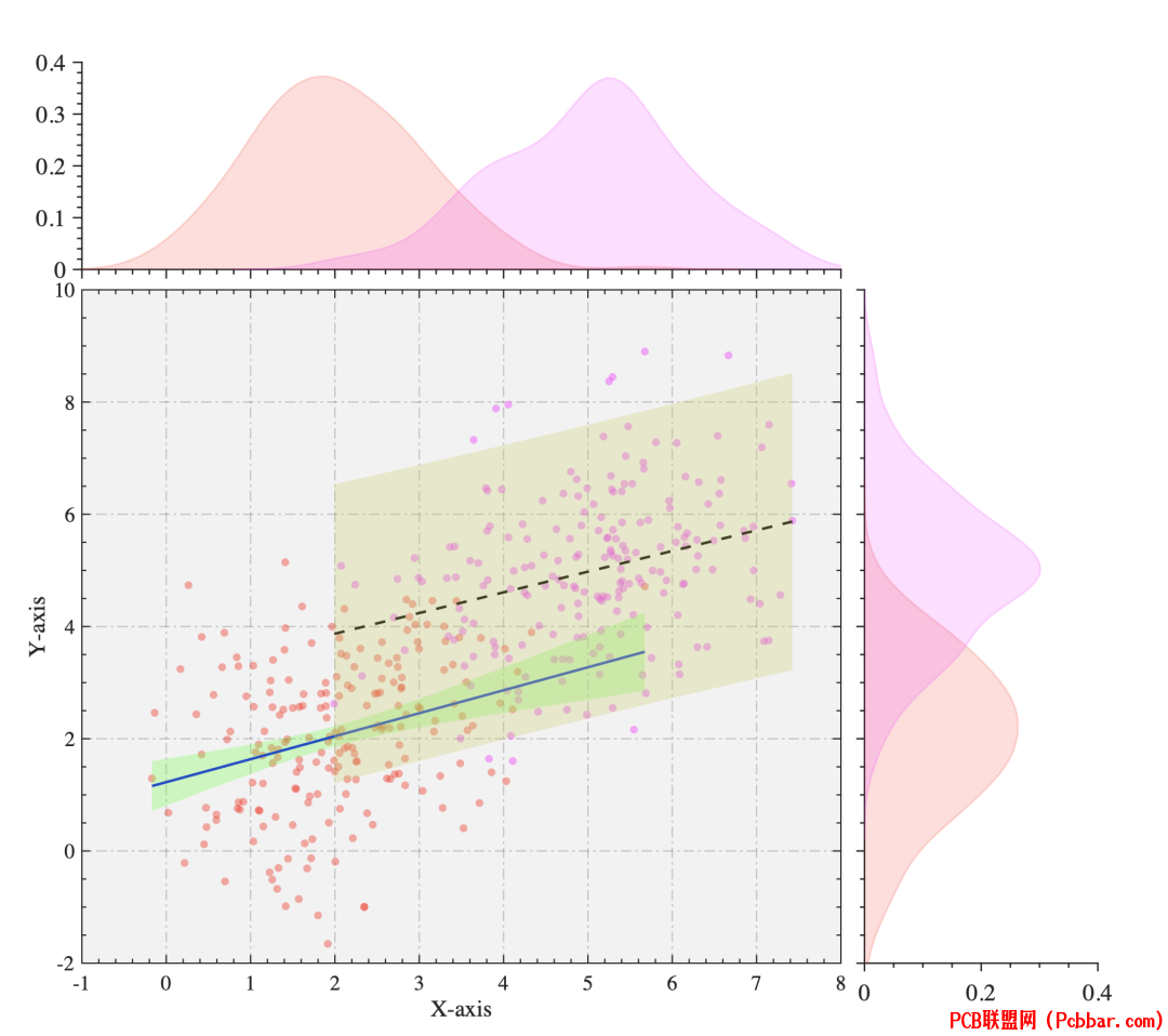

    添加边际图+核密度图. Q" X4 s: u  H$ y$ W2 ?7 I
  • clc;clear;close all;%--------------------------------------------------------------------------% @Author: 好玩的Matlab% @公众号:好玩的Matlab% @Created: 09,06,2023% @Email:2377389590@qq.com% 尊重劳动成果,转载请备注推文链接和公众号名。% @Disclaimer: This code is provided as-is without any warranty.%--------------------------------------------------------------------------% 使用提供的数据data1 = repmat([2 2], 200, 1) + randn(200, 2) * [1 .5; 0 1.32];data2 = repmat([5 5], 200, 1) + randn(200, 2) * [1 .5; 0 1.32];xData1 = data1(:, 1);yData1 = data1(:, 2);1 P. ^& ^, Y  R- Y) {2 U
    xData2 = data2(:, 1);yData2 = data2(:, 2);% 绘制散点图figure('Position',[383 355 886 507]);hold onsHdl1=scatter(xData1, yData1, 'r', 'filled', 'MarkerEdgeColor', 'none', 'MarkerFaceAlpha', 0.4);sHdl2=scatter(xData2, yData2, 'm', 'filled', 'MarkerEdgeColor', 'none', 'MarkerFaceAlpha', 0.4);defaultAxes% 绘制回归线置信区间P1=PlotRegConfInt(sHdl1);P1.LineColor='b';P1.LineWidth=2;P1.plotRegConfInt();P2=PlotRegConfInt(sHdl2);P2.Type='DeCI';P2.FillColor=[1,1,0.5]*0.8;P2.LineStyle='--';P2.LineColor='k';P2.LineWidth=2;P2.plotRegConfInt();
    2 U  f0 L) v3 v/ X  I, [% 设置边际组图Phdl1=PlotDensFill(sHdl1);Phdl1.plotDensFill();; _  ?' h8 r1 a* U8 r
    Phdl2=PlotDensFill(sHdl2);Phdl2.plotDensFill();* ]( j! O4 [# F
    3 _: Y0 m, p/ g+ a9 t8 J
