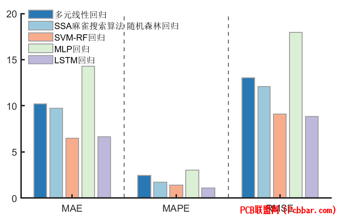

    2.误差柱状对比图
    ; r3 `; l6 ]) W( I3 X6 l
    + s1 w8 i, A6 {+ i! G" lTips:建议选取量纲差别不大的误差衡量指标,不然可能会有点丑3 u6 r3 m5 F4 h3 v( C) B8 u
  • Test_all=[];for j=1:size(data_pre_all,2)    y_test_predict=data_pre_all(:,j);    test_y=data_true;    test_MAE=sum(abs(y_test_predict-test_y))/length(test_y) ;           test_MAPE=sum(abs((y_test_predict-test_y)./test_y))/length(test_y);      test_MSE=(sum(((y_test_predict-test_y)).^2)/length(test_y));     test_RMSE=sqrt(sum(((y_test_predict-test_y)).^2)/length(test_y));      test_R2= 1 - (norm(test_y - y_test_predict)^2 / norm(test_y - mean(test_y))^2);       Test_all=[Test_all;test_MAE test_MAPE test_MSE test_RMSE test_R2];end%%str={'真实值','多元线性回归','SSA麻雀搜索算法 随机森林回归','SVM-RF回归' ,'MLP回归','LSTM回归'};str1=str(2:end);str2={'MAE','MAPE','MSE','RMSE','R2'};data_out=array2table(Test_all);data_out.Properties.VariableNames=str2;data_out.Properties.RowNames=str1;disp(data_out)%% 柱状图 MAE MAPE RMSE 柱状图适合量纲差别不大的color=    [0.1569    0.4706    0.7098    0.6039    0.7882    0.8588    0.9725    0.6745    0.5490    0.8549    0.9373    0.8275       0.7451    0.7216    0.8627    0.7843    0.1412    0.1373    1.0000    0.5333    0.5176      0.5569    0.8118    0.7882       1.0000    0.5333    0.5176];figure('Units', 'pixels', ...    'Position', [300 300 660 375]);plot_data_t=Test_all(:,[1,2,4])';b=bar(plot_data_t,0.8);hold on" j0 n0 E, g0 J( f- G3 K1 U9 A0 J
    for i = 1 : size(plot_data_t,2)    x_data(:, i) = b(i).XEndPoints'; end
    , g: x2 G3 A  `! ?for i =1:size(plot_data_t,2)b(i).FaceColor = color(i,:);b(i).EdgeColor=[0.6353    0.6314    0.6431];b(i).LineWidth=1.2;end, ?6 _8 v$ i4 k' i6 y9 c& h
    for i = 1 : size(plot_data_t,1)-1    xilnk=(x_data(i, end)+ x_data(i+1, 1))/2;    b1=xline(xilnk,'--','LineWidth',1.2);    hold onend 9 e$ G9 S0 B$ z  t
    ax=gca;legend(b,str1,'Location','best')ax.XTickLabels ={'MAE', 'MAPE', 'RMSE'};set(gca,"FontSize",12,"LineWidth",2)box offlegend box off  G8 P) v- J' i6 L; o

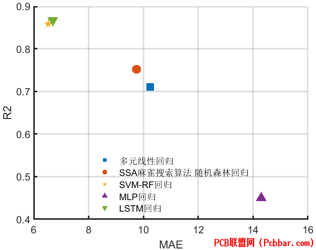

    3.误差散点对比图
    5 i# Y# `6 A4 K5 K
    7 h4 U  t; h9 }/ b* A5 GTips:可以任意选择两个误差衡量维度! Z/ H5 W9 A6 b5 L' c
  • figureplot_data_t1=Test_all(:,[1,5])';MarkerType={'s','o','pentagram','^','v'};for i = 1 : size(plot_data_t1,2)   scatter(plot_data_t1(1,i),plot_data_t1(2,i),120,MarkerType{i},"filled")   hold onendset(gca,"FontSize",12,"LineWidth",2)box offlegend box offlegend(str1,'Location','best')xlabel('MAE')ylabel('R2')grid on

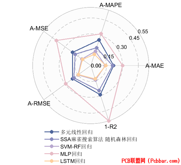

      \5 s$ A+ x& M- c& B, k/ `5.误差雷达图
    $ p" p3 O$ q7 f/ g1 d. ]+ i
    ( O4 l* W9 ~  Y* L2 q. aTips:为了让图片更美观将多个维度评价指标进行归一化处理了! N- c6 `6 k9 L
  • figure('Units', 'pixels', ...    'Position', [150 150 520 500]);Test_all1=Test_all./sum(Test_all);  %把各个指标归一化到一个量纲Test_all1(:,end)=1-Test_all(:,end);RC=radarChart(Test_all1);str3={'A-MAE','A-MAPE','A-MSE','A-RMSE','1-R2'};RC.PropName=str3;RC.ClassName=str1;RC=RC.draw(); RC.legend();colorList=[78 101 155;          138 140 191;          184 168 207;          231 188 198;          253 207 158;          239 164 132;          182 118 108]./255;for n=1:RC.ClassNum    RC.setPatchN(n,'Color',colorList(n,:),'MarkerFaceColor',colorList(n,:))end

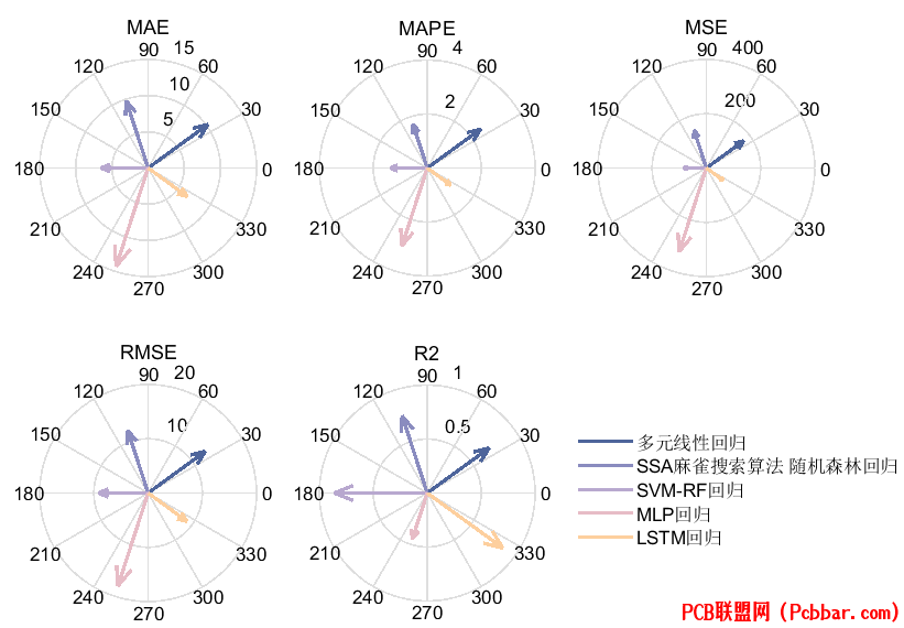

    + d" ?; l( F8 q4 y1 g' x, h) e6.误差罗盘图  N0 Q) X, \$ |1 T1 n
    * u$ |; R6 w) q4 c% i# {
  • figure('Units', 'pixels', ...    'Position', [150 150 920 600]);t = tiledlayout('flow','TileSpacing','compact');for i=1:length(Test_all(:,1))nexttileth1 = linspace(2*pi/length(Test_all(:,1))/2,2*pi-2*pi/length(Test_all(:,1))/2,length(Test_all(:,1)));r1 = Test_all(:,i)';[u1,v1] = pol2cart(th1,r1);M=compass(u1,v1);for j=1:length(Test_all(:,1))    M(j).LineWidth = 2;    M(j).Color = colorList(j,:);5 P. A( n7 b0 A! ]$ ]' A4 e
    end   title(str2{i})set(gca,"FontSize",10,"LineWidth",1)end legend(M,str1,"FontSize",10,"LineWidth",1,'Box','off','Location','southoutside')2 J& h; o6 D7 ^* f1 d
