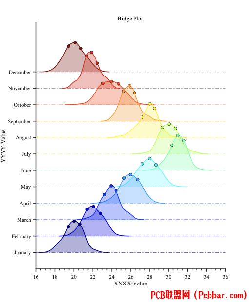

    填充山脊图
  • data = randn(100,12)+[ 20 22 24 26 28 31 30 28 26 24 22 20];lgLable= {'January', 'February', 'March', 'April', 'May', 'June','July', 'August', 'September', 'October', 'November', 'December'};% colors=makeColorMap(winter,size(data, 2));colors=makeColorMap(jet,size(data, 2));figure('Position',[476 246 511 620])p =0.2;hold on;for i = size(data, 2):-1:1    [f, x] = ksdensity(data(:, i));    fShifted = f + i * p;    pHandle = plot(x, fShifted,'color',colors(i,:),'LineWidth', 1.5,'HandleVisibility', 'off');    yline(i * p, '-.', 'LineWidth', 1, 'Color', colors(i,:),'HandleVisibility', 'off')    Xfill = [x, fliplr(x)];    Yfill = [fShifted, ones(1, length(x)) * i * p];    fill(Xfill, Yfill, pHandle.Color, 'EdgeColor', 'none', 'FaceAlpha', 0.3);endyTick = (1:size(data, 2)) * p;set(gca, 'YTick', yTick, ...    'YTickLabel', lgLable, ...    'LineWidth', 1.5, 'XMinorTick', 'on', 'TickDir', 'out', ...    'fontname','Times new Roman');xlabel('XXXX-Value');ylabel('YYYY-Value');title('Ridge Plot');ax = gca;hold off;?

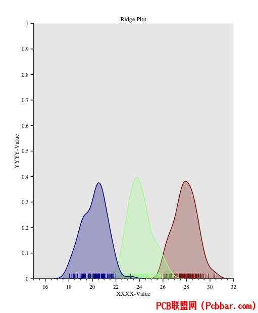

    ( o( ~* ?; p5 w+ y不同核山脊图、添加边际散点密度
  • data = randn(100,3)+[ 20  24 28];colors=makeColorMap(jet,size(data, 2));figure('Position',[476 246 511 620])p=0;hold on;yTick=(1:size(data, 2))*p;lineLength = 0.02; % 竖线的长度for i = size(data, 2):-1:1    [f, x] = ksdensity(data(:, i));    fShifted = f + i * p;    pHandle = plot(x, fShifted, 'color', colors(i,:), 'LineWidth', 1.5, 'HandleVisibility', 'off');    yline(i * p, '-.', 'LineWidth', 1, 'Color', colors(i,:), 'HandleVisibility', 'off');    Xfill = [x, fliplr(x)];    Yfill = [fShifted, ones(1, length(x)) * i * p];    fill(Xfill, Yfill, pHandle.Color, 'EdgeColor', 'none', 'FaceAlpha', 0.3);    for j = 1:length(data(:, i))        line([data(j, i), data(j, i)], [i * p, i * p + lineLength], 'Color', pHandle.Color, 'LineWidth', 1);    endendgrid off;box off;ax=gca;set(ax,'LineWidth', 1.5, 'XMinorTick', 'on', 'TickDir', 'out', ...    'fontname','Times new Roman','color',[1,1,1]*0.9);ax.YLim=[0,1];ax.XLim=[15,32];xlabel('XXXX-Value');ylabel('YYYY-Value');title('Ridge Plot');hold off;! r+ i% o' a4 X3 U

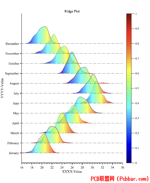

    横坐标方向、全局渐变的散点图
    , f1 C3 M' r3 _; e- a
  • data = randn(100,12)+[ 20 22 24 26 28 31 30 28 26 24 22 20];lgLabel={'January', 'February', 'March', 'April', 'May', 'June',    'July', 'August', 'September', 'October', 'November', 'December'};p = 0.2;numColors = 256;% 创建一个从紫色到红色再到黄色的颜色映射colorMap =makeColorMap([0.1490    0.0353    0.5608;0.7305    0.2500    0.4922;0.9569    0.9490    0.1765],numColors);% 计算全局的x轴范围xMin = min(data, [], 'all');xMax = max(data, [], 'all');figure('Position',[476 246 511 620])hold on;for i = size(data, 2):-1:1    [f(i,:), x] = ksdensity(data(:, i), 'Kernel', 'triangle');    fShifted = f(i,:) + i * p; % 偏移每个分布    plot(x, fShifted, 'LineWidth', 1.5, 'color', 'k', 'HandleVisibility', 'off');    yline(i * p, '-.', 'LineWidth', 1, 'HandleVisibility', 'off');    for j = 1:length(x)-1        Xfill = [x(j), x(j+1), x(j+1), x(j)];        Yfill = [i * p, i * p, fShifted(j+1), fShifted(j)];        % 计算当前点的颜色比例        colorRatio = (x(j) - xMin) / (xMax - xMin);        colorIdx = min(numColors, max(1, round(colorRatio * (numColors - 1)) + 1));        fill(Xfill, Yfill, colorMap(colorIdx, :), 'EdgeColor', 'none', 'FaceAlpha', 0.9);    endend% 设置轴标签和标题yTick = (1:size(data, 2)) * p;set(gca, 'YTick', yTick, ...    'YTickLabel', lgLabel, ...    'LineWidth', 1.5, 'XMinorTick', 'on', 'TickDir', 'out', ...    'fontname','Times new Roman');xlabel('XXXX-Value');ylabel('YYYY-Value');title('Ridge Plot');% 设置颜色条colormap(colorMap);cBar = colorbar;cBar.TickDirection = 'out';cBar.LineWidth = 1;cBar.TickLength = 0.02;cBar.FontName = 'Times new Roman';caxis([xMin,xMax]);hold off;* D# P8 e1 E5 m% o' r
    8 U: g, \! N7 [$ ~* F: r0 P' ?9 _
    横坐标方向、单核渐变图
  • data = randn(100,12) + [20 22 24 26 28 31 30 28 26 24 22 20];lgLabel = {'January', 'February', 'March', 'April', 'May', 'June', 'July', 'August', 'September', 'October', 'November', 'December'};numColors = 256; % 颜色数量colors = jet(numColors); % 使用jet颜色映射figure('Position',[476 246 511 620])p = 0.2;hold on;for i = size(data, 2):-1:1    [f, x] = ksdensity(data(:, i));    fShifted = f + i * p;    plot(x, fShifted, 'LineWidth', 1.5, 'HandleVisibility', 'off');    yline(i * p, '-.', 'LineWidth', 1, 'HandleVisibility', 'off');    colorGradient = linspace(1, numColors, length(x));    for j = 1:length(x)-1        Xfill = [x(j), x(j+1), x(j+1), x(j)];        Yfill = [i * p, i * p, fShifted(j+1), fShifted(j)];        fill(Xfill, Yfill, colors(round(colorGradient(j)), :), 'EdgeColor', 'none', 'FaceAlpha', 0.7);    endendyTick = (1:size(data, 2)) * p;set(gca, 'YTick', yTick, 'YTickLabel', lgLabel, ...    'LineWidth', 1.5, 'XMinorTick', 'on', 'TickDir', 'out', ...    'fontname', 'Times new Roman');xlabel('XXXX-Value');ylabel('YYYY-Value');title('Ridge Plot');colormap(colors);cBar = colorbar;cBar.TickDirection = 'out';cBar.LineWidth = 1;cBar.TickLength = 0.02;cBar.FontName = 'Times new Roman';hold off;- P# U8 V4 w5 W: M( }! @" W# g

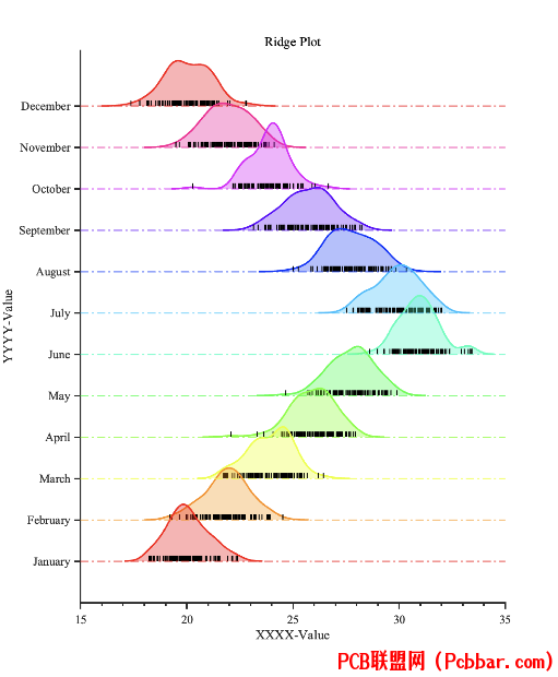

    3 ]* F9 K9 d& U3 _+ `每个山脊图设置不同颜色,且添加边际散点图
  • data = randn(100,12)+[ 20 22 24 26 28 31 30 28 26 24 22 20];lgLable = {'January', 'February', 'March', 'April', 'May', 'June', 'July', 'August', 'September', 'October', 'November', 'December'};figure('Position', [476 246 511 620])p = 0.3;lineLength = 0.04; % 竖线的长度colors=makeColorMap(hsv,size(data, 2));hold on;for i = size(data, 2):-1:1    [f, x] = ksdensity(data(:, i));    fShifted = f + i * p;    pHandle = plot(x, fShifted, 'color', colors(i,:), 'LineWidth', 1.5, 'HandleVisibility', 'off');    yline(i * p, '-.', 'LineWidth', 1, 'Color', colors(i,:), 'HandleVisibility', 'off');    Xfill = [x, fliplr(x)];    Yfill = [fShifted, ones(1, length(x)) * i * p];    fill(Xfill, Yfill, pHandle.Color, 'EdgeColor', 'none', 'FaceAlpha', 0.3);    for j = 1:length(data(:, i))        line([data(j, i), data(j, i)], [i * p, i * p + lineLength], 'Color', 'k', 'LineWidth', 1);    endendyTick = (1:size(data, 2)) * p;set(gca, 'YTick', yTick, ...    'YTickLabel', lgLable, ...    'LineWidth', 1.5, 'XMinorTick', 'on', 'TickDir', 'out', ...    'fontname', 'Times new Roman');xlabel('XXXX-Value');ylabel('YYYY-Value');title('Ridge Plot');
